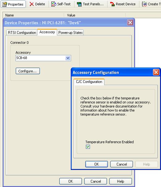

1.  Open up the Measurement and Automation Explorer (MAX).
2.  Navigate to My System>> Devices and Interfaces>> DAQmx Devices>> PCI-6281.
3.  Right click on the PCI-6281 and select Properties.
4.  Go to the Accessories tab of the Device Properties window, select the SCB-68 as the accessory, and click configure.
5.  In the Accessory Configuration windows check Temperature Reference Enabled.
Here's a screenshot of steps 3 to 5:
I hope this helps, and have a great day!
