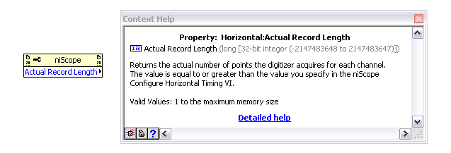

Hi Everybody,
Thanks for the suggestions Kate!  You can also read back the Actual record size directly through the niScope API--in LabVIEW it can be done with an niScope Property Node:
If you were looking for something else don't hesitate to let us know.  I hope this helps.
-John
Message Edited by John P on 12-01-2009 07:25 PM
