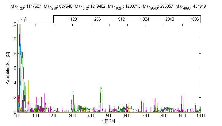

I made a small comparison how my measurement system performs if File write size varies. Below you can see some results.
23698i3A48C489E64A63B1
Fig. 1  Available samples per channel measured during high-speed data acquisition with sampling rate of 1MS/s/ch.

For this test the buffer size was defined as 1MS. The best performance was reached for 2048S file write size in both cases. For value 512S the buffer was overwritten. Available samples per channels exceed the input buffer size and the data acquisition process fails. In case of 2.5MS/s/ch sampling rate 128S and 1024S failed as well.

Also from figures presented above it can be seen that for file write size lower than 512S (the HDD sector size is 512B) some trends in buffer usage are recognizable. This can be affected by I/O overall performance.
Looking forward to hearing your comments.
