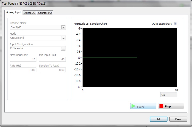

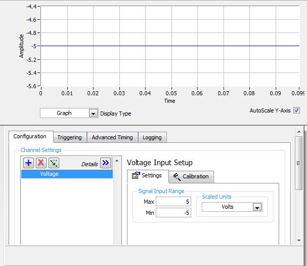

I have a PCI 6033e card that has been running for a long time on an old computer (Windows 2000) that recently has the same issue as described in THIS post. The voltage reading in any NI-DAQmx tasks, or any VI run in LV is always the minumum voltage value in the negative domain, with no noise (i.e. -5V, -10V etc). When the voltage range is set to greater than 0V (i.e. 1V-5V) the voltage is a steady 0V.
