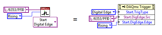

Essentially the DAQmx Property Nodes are needed to configure the more advanced features of a DAQ device.  You can also use them for some of the basic functionality which is also configurable through the DAQmx Sub VIs.  For example:

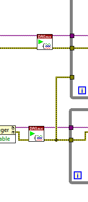

There's also a race condition youl'l want to correct.  Simply wiring the error from the Start of the bottom task to the top loop should do the trick:
