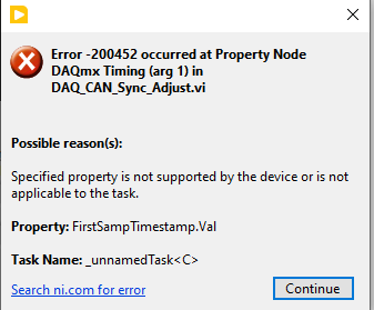

However, after trying your code I get this error, saying that the property is not supported. I cannot find any information regarding device compatibility and that property. Furthermore, I cannot even select the property. I can find it when I search the class DAQmx timing class, but I am unable to select any of the "Advanced:[...]" properties regardless of the hardware selected. The "Advanced" properties should be shown under "More.." when clicking on the property node, but they are not. Any idea why I cannot select or even see that property?

(4,919 Views)
In that case, you can use the t0 of the first sample. The start trigger is generated on the first sample clock.
