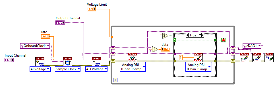

So far, I have just used a case structure:example.png

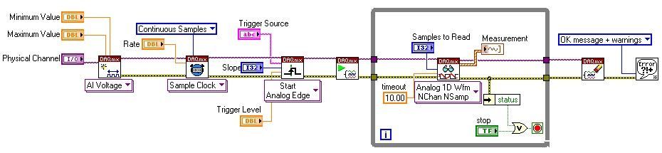

However, I would like to use Analog Hardware Triggering like on this page (example below): https://www.ni.com/en/support/documentation/supplemental/21/ni-daqmx-data-acquisition-triggering-tec...
Analog_Start_Triggering_in_LabVIEWIn the example above, I believe it starts recording data once the threshold is reached, however, I would like to be recording the voltage the entire time and once the threshold is reached, stop the voltage acquisition and then generate voltage output. Thank you!

I have successfully done this with software in labview, however, it takes about 40 milliseconds for the software to send the output voltage to shutdown the supply, I would like to minimize this time using hardware triggering if possible.

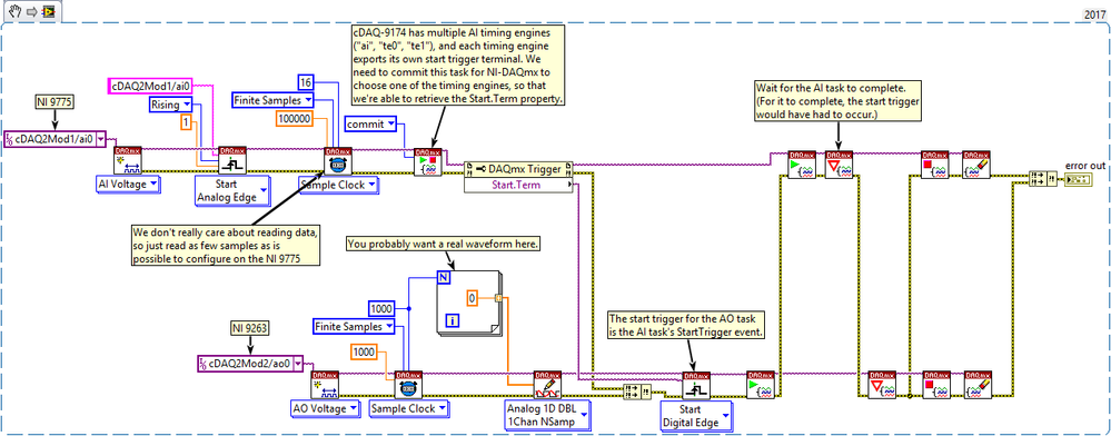

Yes. You have to configure the trigger on the AI task, and then import the trigger on the AO task. Here's a quick example. (Disclaimer: I've only tried this with a simulated NI 9775 and NI 9263, and not real hardware).
In this example, I configure a rising-edge analog trigger on the AI task, then query its Start.Term[1] property to be imported on the AO task. The AO task is loaded with the data to be written, with a configured start trigger so that it will wait on the AI task's StartTrigger. We start the AO task first (so that it's ready to receive the start trigger) and then the AI task (which will generate the start trigger), then just wait for everything to complete. In this example, we never read from the AI task, because we don't care about the data at all-- we just care that the hardware observes the trigger condition.
You'll probably have to play around with it (at least you'll probably want a AO waveform that's not 1000 samples of zeros!), but I think that's the general flow you'd be looking at.
[1] On cDAQ, this does require explicitly reserving or committing the task to retrieve that property because it has multiple timing engines, although I could have also explicitly chosen one with the SampTimingEngine timing property.

So in this example you've provided, it seems that the AO task will just start when the AI task has started, however is it possible to have the AO task be triggered by a certain level of analog input? i.e. Can I use an analog trigger with the AO task?
I am trying to configure it so that the AO task runs once a certain level of analog input is detected

If your question is "can I set an AI analog trigger directly on the AO task" the answer is no. The analog comparator from the AI module connects to the AI timing engine, so you can only get at it through the AI timing engine. That's what I've done in the above example-- I configure the AI task with the appropriate settings as a start trigger condition, and then I export the AI StartTrigger event[1] to the AO timing engine.
Unfortunately, the way in which I connect them in that example doesn't allow you to read and process the input data, and so if you need to also read and process the input data I don't see a way around that using hardware-based triggering.
You can only have one AI task per module, so that rules out having an AI task purely to function as a trigger and an AI task for reading the data.
The Analog Comparison Event[2] might be an option, but it's not possible to configure the analog comparator without also configuring an analog trigger, but configuring a Start or Reference trigger on your AI task will prevent you from reading data until the trigger condition has occurred. A pause trigger might work, but the NI 9775 does not support pause triggers[3]. (The NI 9205 and 9206 do, however. Other ) A pause trigger would also pause your AI acquisition while the condition is met, although you've expressed a desire to "stop the AI task" so perhaps that's not actually a detriment here.
There's also the possibility of moving to CompactRIO, where you can implement your own custom datapath triggering with LabVIEW FPGA (and any AI module, since you'd be building your own comparison circuit in the FPGA). That may be a rather large jump, though.
Looking back on your original, software-based approach: you might also be able to reduce the software overhead time by calling DAQmx Start on your AO task before entering your loop. In the DAQmx Task State model, when you create your on-demand AO task, it is in the "Unverified" state. Calling DAQmx Write on it causes the driver to advance the task (implicitly) into the running state, then unwinds it back. By calling DAQmx Start beforehand, you will have explicitly set the task into the "Running" state and so DAQmx will not automatically unwind it. You'll still have software processing latency between reading AI and writing AO, but it may be possible to shave down that "about 40 milliseconds" number slightly.
