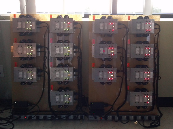

Spend the money on a good USB hub.  Lately I've been using Startech's 4-port and 7-port hubs with good success.  Far better than the cheap consumer-grade stuff, without the excessive cost of the Moxa offerings.  Other nice thing with the Startech hubs, inside them is a pair of jumpers that allows you to enable/disable self-power and bus-power modes.
Another thing, in Windows Device Manager, go through all the 'Generic USB Hub' and 'USB Root Hub' and uncheck "allow the computer to turn off this device to save power".  All that does is cause problems.
6008 in each one of these, one 7-port hub per board, two boards into one computer.
Lotsa DAQs.
