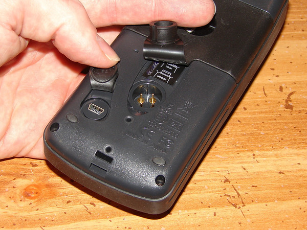

What's the 6009 plugged into?  There's cheap GPS receiver options out there, either bluetooth or serial that output NMEA strings.  Most handheld receivers have a serial connection (pic related, my 76Cx has both 9600-baud serial and USB output).  Connect the receiver to the host PC and read/parse those strings.
