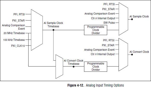

It sounds like you're actually asking whether you can use the DAQ card to divide-down the external 10 MHz timebase to achieve a 100 kHz sample clock, rather than using an external sample clock.
Indeed this is possible as well.  Unlike the PCI or PXI equivalents, the USB 6251 doesn't take an external reference clock (i.e. PLL) since it doesn't have any RTSI connectors.  However, instead you can use the 10 MHz clock as your AI Sample Clock Timebase.  The following image from the M Series User Manual shows a functional block diagram of the AI timing:

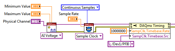

Programming in DAQmx, you just need to tell the driver what the rate and source of your timebase is, and the driver will select the divider for you based off of the desired sample rate:
            18419i01928F824C3E2678
Be sure to pick Sample Clock Timebase, not Master Timebase (E Series Only) or Reference Clock (Not Available on USB M Series).

Hi Gary and John.
Thank you for your answer. I really wanted to know how to divide-down external timer frequency. The last way works good.
