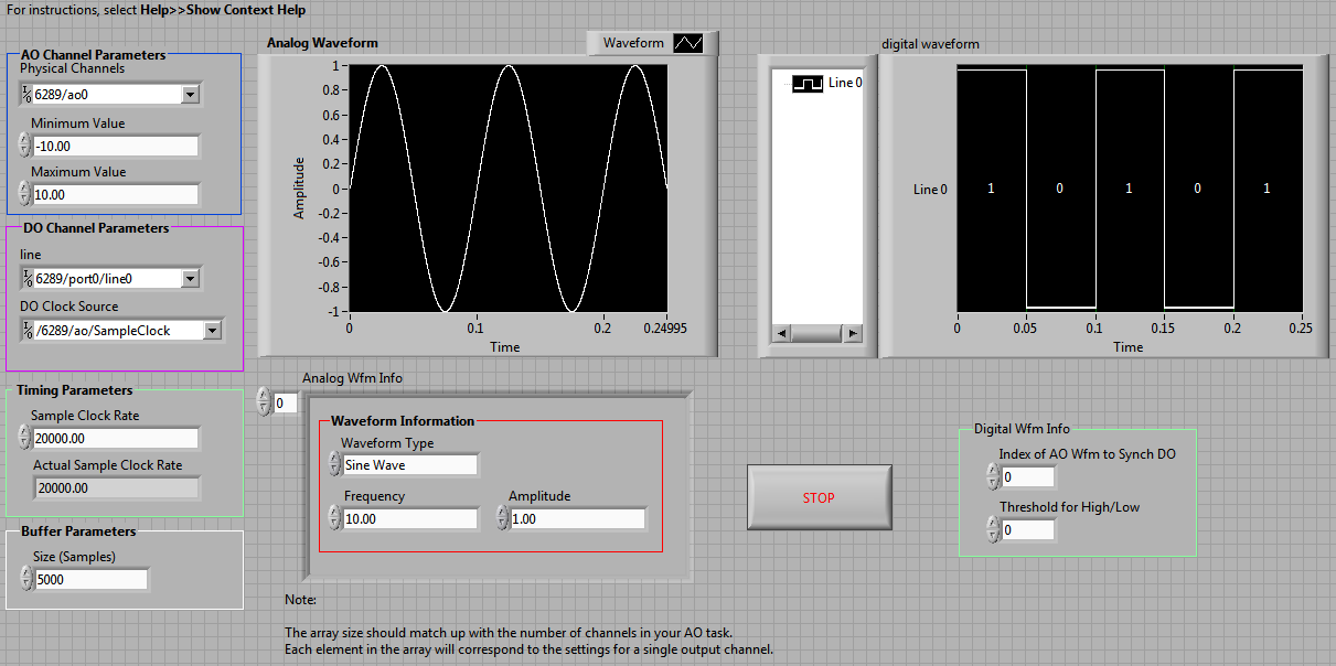

You could generate both sine and square waves on the AO lines if you wanted to since there are 2 AO channels on the 6251.  A good example to start with is:
Generate Multiple Channels of Analog Output with Different Frequencies
If you need both AO lines for two channels of sine wave generation but also want to add TTL pulse generation, you should build a digital waveform and synchronize a DO task with the AO sample clock.  The following example shows how you can synchronize the two tasks but you will need to build the digital waveform yourself:
Correlated Digital Output with Analog Output Sample Clock
You could go with the counters as well, but the 6251 has the capability for clocked Digital Output so this is probably how I would approach the application.

Thanks John, I have tried doing that with DO (I cannot use AO) but I need a bit more form the device. Basically, at the moment I am generating two sine (or triangular) functions with two AO and I need to generate TTL pulses of the same periodicity and in sync with the two AO (which are in sync between themselves but of different period). Would the device be capable of doing that?
Egid
Message 8 of 14
(7,030 Views)
Hi Egid,
Try this example, if I understand correctly it should be what you need to do:
John Passiak
