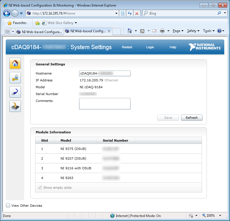

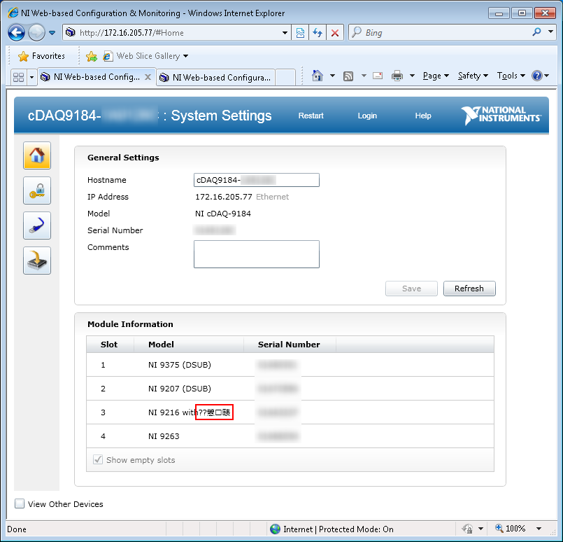

So, I tried with another computer an noticed that the "undiscoverable" cDAQ shows a glitch in one of the module names:
Good cDAQ
Glitched cDAQ
(Remember: I was able to manually add the good cDAQ to NI MAX, but couldn't do that for the glitched cDAQ.
So, I removed the glitched module from Slot 3, rebooted the cDAQ, and voila I could add it without any issues. After that, I put the module back into Slot 3 and the glitch was gone and the system continued working just fine.
What could have caused that?
