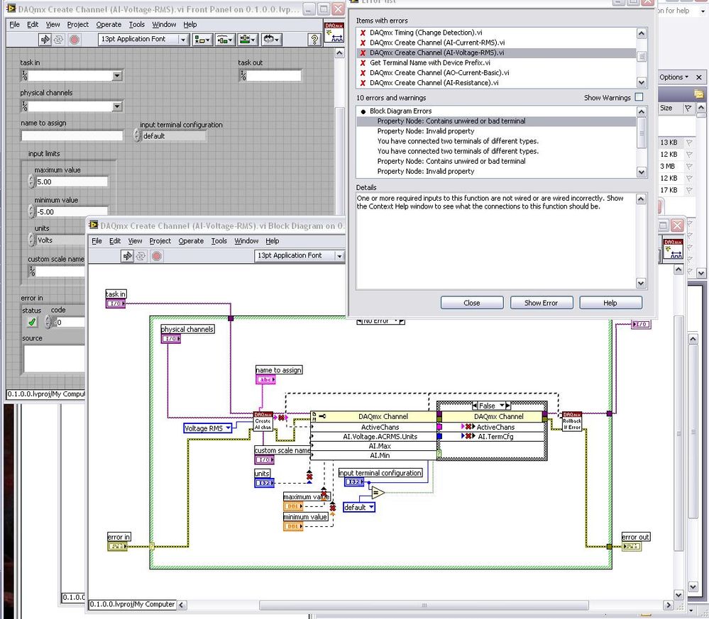

I am able to run my program without any issue in LV8.6. I upgraded to LV2009, and now (along with many vi's) none of the DAQmx vi's are working. I am gettin all kinds of Property Node errors in the DAQmx vi's
Any ideas?

You need to upgrade NI-DAQmx too. NI-DAQmx 8.9.5 and NI-DAQmx 9.0 support LabVIEW 2009.

I thought I had installed 9.0 when I upgraded to LV2009.
To be sure I downloaded the DAQmx9.0 from ni.com and reinstalled.
All is well now.
