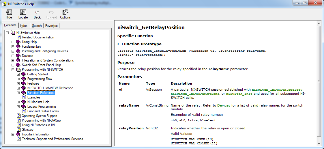

Hi Joel,
I believe this is the function you are looking for.
NI Switches help can be found under the start menu, National Instruments, NI-Switch, and Documentation.

Lisa, thank you. That was most helpfull. Your post lead me to discover this article.
http://zone.ni.com/devzone/cda/epd/p/id/1648
And from there I was able to adapt the source code for my own needs. I was previously unaware there was a module for using NISwitch with .NET.
