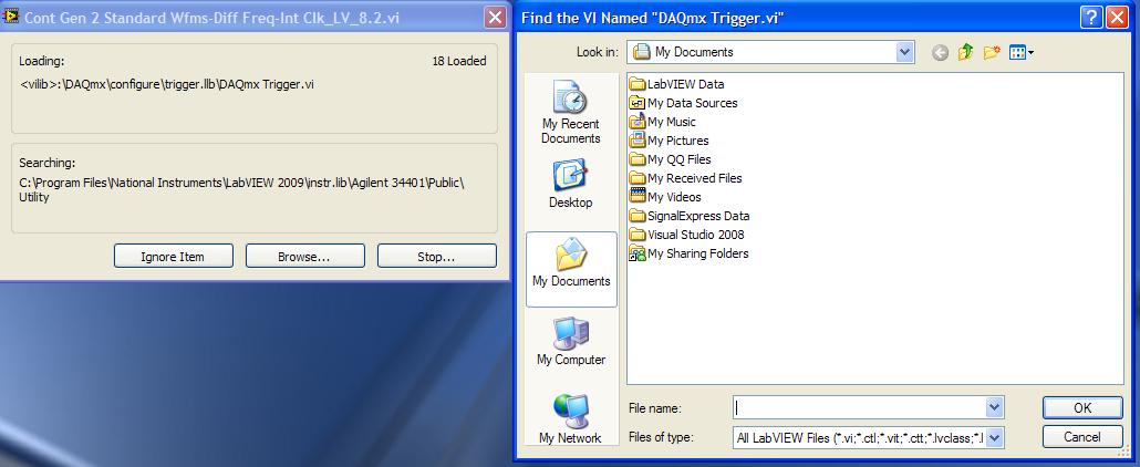

Now, when i downloaded the example VI and ran it on labview, i was given the indication that i am missing a few files:
-  "DAQmx Trigger.vi"
-  "DAQmx Timing (Sample Clock).vi"
-  "DAQmx Create Channel (AO-Voltage-Basic).vi"
-  "DAQmx Write (Analog 1D Wfm NChan NSamp).vi"
-  "DAQmx Is Task Done.vi"
-  "DAQmx Clear Task.vi"
-  "DAQmx Write.vi"
-  "DAQmx Start Task.vi"
-  "DAQmx Create Virtual Channel.vi"
-  "DAQmx Timing.vi"
For example, when i initially click on the VI for the sample code i found online to open the file, this message appears:
Only after i click "ignore item" or "cancel" will it open the VI.
