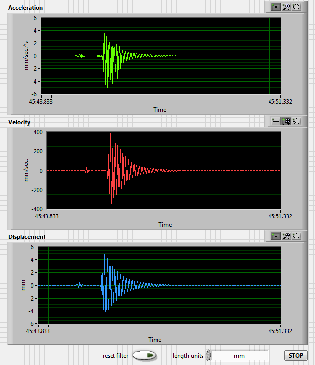

This might be a stupid question with a simple answer.  We're working on a project that requires acceleration, velocity, and distance data over time.  We're using the NI 9234 in a compactDAQ chassis connected to an accelerometer.  The accelerometer is attached to a cantilevered plastic subject (rectangular) that is "plucked" -- sort of like a ruler over the edge of a table sprung like a diving board.  We're acquiring at about 2k samples/sec and using the Sound and Vibration Toolkit's integration VI to derive velocity & distance.  Charting it, this is what we get:
17511iC219C3D5180F659D
We set up a task and used the defaults for the 9234 to convert voltage to g.  But "g" is both an SI and English unit (m/sec^2 or ft/sec^2).
My question is, charting it, what would be the units and scale for both velocity & distance?

 First : g is not a SI !
The nice thing about the SI- units is that they even work together with math 😉 a  or have you seen a distance measured  0.10193679918451 gs² (= 1m)
So if you feed  m/s² into an (time) integrator you receive velocity in m/s , repeat it and you get distance in m .

Henrik,
Thanks for responding.  Here's my data below.  Would you be so kind to explain what you mean by this statement:
""The nice thing about the SI- units is that they even work together with math a  or have you seen a distance measured  0.10193679918451 gs² (= 1m)
So if you feed  m/s² into an (time) integrator you receive velocity in m/s , repeat it and you get distance in m .""
the information is in English the displacement is "INCHES".  An additional question is "WHAT IS 5.11756?"   Is it "g's"?
