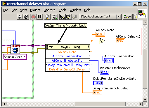

For most E and M series devices we use interval sampling, utilising 2 clock signals a Scan Clock and a AI Convert Clock.
The AI Convert Clock tells the multiplexer to increment and the ADC to take a reading. So with the use of a DAQmx timing Property node, we can work out the interchannel delay for a given sample rate.
Please see the attached screenshot or the example code in LV 8.0 format.
Regards
JamesC
