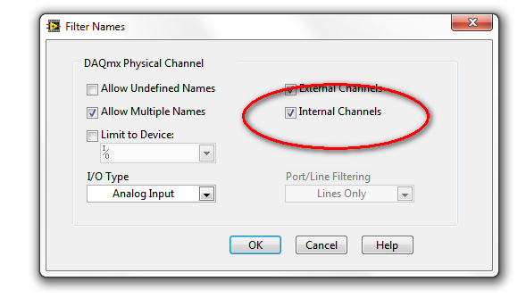

Do you need to measure the AO voltage using an AI channel on the same DAQ card?  You can actually route this internally without having to make any external connections at all by using "Dev1/_ao0_vs_aognd" as the channel in your ai task.
You would need to right-click on the channel constant or control, and select IO Name Filtering to choose the option to select Internal Channels:
The terminal configuration in this case must be "Differential", which is the default.  This will route AO_GND to the (-) terminal of the ADC, and AO0 to the (+) terminal.
