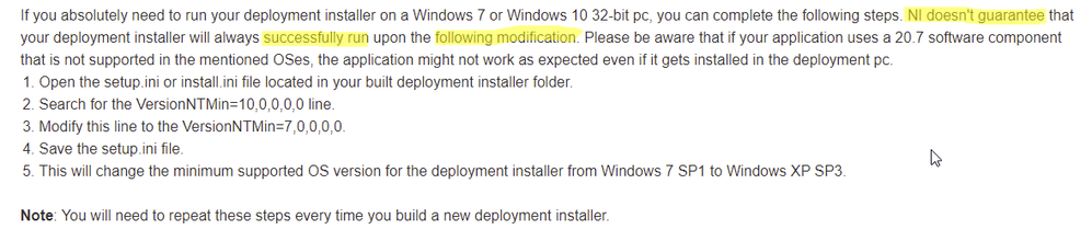

First I have got an Windows version Problem. This is solved by changing the VersionNTMin in the *.ini file.

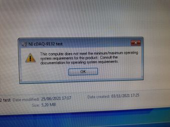

Second, the system doe not meet the requirements.
What is wrong?

Looks like you've configured a minimum system OS requirement for the installer and the PC you're installing on does not meet those requirements.
You do not need LV RT, since it is just a desktop application. Have you included appropriate run-time engine versions for the dependencies such as DAQmx?
What OS version are you installing the application? sometimes the dependencies such as DAQmx has strict OS requirements which cannot be overridden.

You have to set minimum system requirements in the Installer properties. An other setting doesn't change anything.
I've changed VersionNTMin in the ini file to 0,0,0,0,0. Now it is installable.

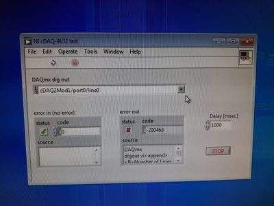

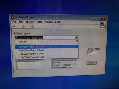

An Relay output module 9481 is inside the cDAQ-9132.
The outputs are visible in the port setting but an error occurs.
I am familiar with DAQmx, but what is wrong? Through MAX (version 16) the relays are controllable!

Yes, you did a hack to work around the requirement set by the developer to avoid unintended consequences.
But at the core of it is still the same issue, any installer developed with 20.7 MDF Support component is not guaranteed to work in a Win7 environment.
Alternative - build your application with software dependencies lower than 20.7, for example with the drivers at 19.0 versions.
