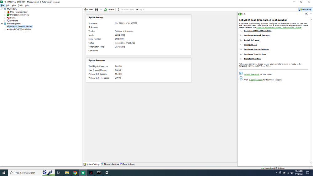

After several restart my laptop and 9132, still the same. The status LED flash twice every few seconds.The status in MAX is "Inconsistant IP Settings". Here is a screenshot:

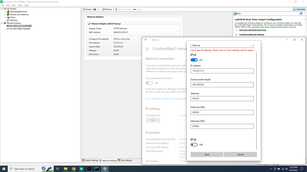

Here is the network setup. As in DHCP, 9132 has ip 172.22.11.2, my laptop has ip 172.22.11.1, I tried to set static ip on my laptop, but it doesn't allow me. I can ping 9132 from my laptop, but cannot ping my laptop from 9132.
