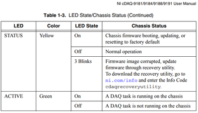

I am having one problem. My cDAQ 9184 Chassis is not detecting in NI MAX and the status LED is three times blinking yellow color. I am trying to troubleshoot but not getting success. I follow under below link but still, the chassis is not detecting.

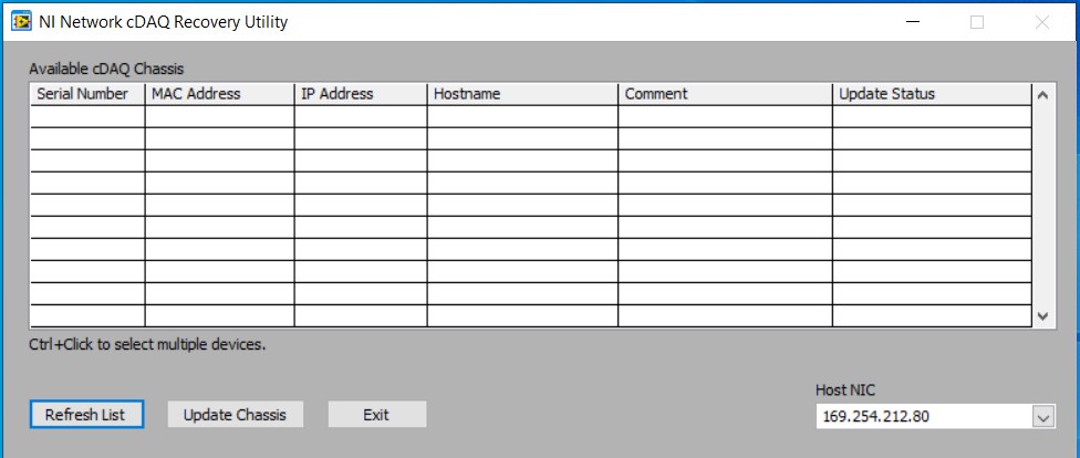

Thanks for the information. I follow the steps which you have mentioned. Unfortunately, it is also not detecting chassis here. On the bottom right side of the photo HOST NIC IP address is detecting but in the table chassis is not detected. Even many times Refresh List and Update Chassis bottom clicked did but not get success.
Best Regards,
Abhishekkumar Gupta
