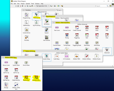

Once you can control the chassis in Max look at the DAQmx Reserve Network Device.vi and DAQmx Unreserve Network Device.vi.

BTW I am thinking I might have to install that DAQmx reserve and unreserve Vis to my 2 Vis so that they both can take control (Reserve) when they launch.

Well I ended up adding the DAQmx Reserve and a Unreserve  to both Vis. I believe it has taken me one more step closer to getting this to work. I am still having some troubles with the second installed Executable.
