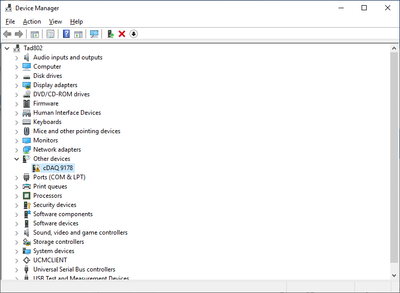

cDaq-9178 attached to windows 10 64 bit
the unit worked in an old computer with window7.
changed the computer with windows 10 64 bit .
in Device Manager getting an error
The drivers for this device are not installed. (Code 28)
There are no compatible drivers for this device.
To find a driver for this device, click Update Driver.
clicked o update and got
Please Help
Aufgang Arieh
Aufgang@tadiran-batt.com
(3,903 Views)
Drivers for the cDAQ-9178 are not available from Windows Update. You'll need to install NI-DAQmx.
