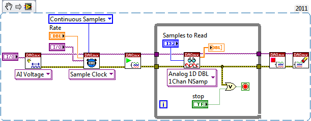

1.  When asking for a specific number of samples per loop, even a simulated device will block the loop for the amount of time that it would have taken for your data to be available based off of the specified Rate (ignoring clock source).  The loop time should be approximately equal to (Samples to Read / Rate):

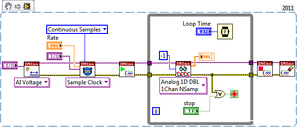

2. When reading all available samples (-1), the simulated device is also able to give you the number of samples which is approximately equal to the expected number of samples that would have been acquired since your last read.  Here, the array size returned by the read should be approximately equal to (Loop Time/1000)*Rate (where Loop Time is in ms and Rate is in Hz).  Notice again that the clock source is irrelevant for simulated devices, but the specified rate does affect how much data is returned.

Simulated devices do an OK job with simulating the timing of data, but they do this based off of your specified rate alone.  The purpose is to give a good idea of what the program might behave like, but simulted devices aren't always a completely accurate representation of real hardware.
Simulated devices do not accurately simulate timing when you are synchonizing multiple devices.  As we have seen, they do not use the sample clock input.  They also trigger immediately.  If you have two synchronized tasks, any amount of time between the start (in software) of each task will show up as a discrepancy in when the samples are returned (in case 1 above) or the number of samples returned by the first read call (in case 2 above).  Subsequent read calls (in case 2) should be more closely aligned, but they might not be exactly the same (this is also true for real hardware).
Since you mentioned that you are not getting the same number of samples between tasks, it sounds like you might be reading -1 samples.  If it is important to you to have the same number of samples, it would probably be better to specify the desired number when you call DAQmx Read.  Some people don't do this since the Read call will block until the desired number of samples have been taken.  There are ways around this as well (you can poll Available Samples per Channel or you can configure a DAQmx Every N Samples event).
