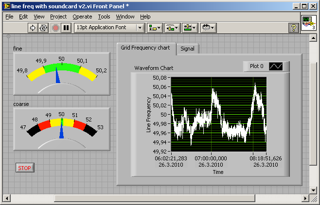

Here is my approach: I used the soundcard mic input to catch line hum and analyses it.
I used a headphone plugged into the mic 😛 and placed it closed to a wall plug transformer (A traditional heavy one, not the switched ones 😉  , somewhere I have one of these old inductive telephone pickups, they should would work better.
The program catch 2 seconds of hum and noise, bandpass filter for the line freq and uses the Extract Single Tone Information VI to get the main frequency.
Things to add and improve:
  • Record to file
  • Best would be to use a wall plugged transformer with some volt AC output and a voltage divider to fit the line input... RC pre filter ... but hey that is for fun 🙂
  • Frequency detection via SAM Sinus Approximation. I already tried it and it works better, however that code didn't belong to me so I can't share it. Try a 4 parameter fit with a*sin(w*x)+b*cos(w*x)+c  it is slow as an express vi , but more stable
  • Add alarms if more than 2% off because at least at that moment the grid will fall apart.....
  • Run it against the HP3458 powerline freq measurement....
 here you can see that my use-the-headphone-as-magnetic-pickup has a real bad SNR 🙂 red is signal before white after bandpass filter

here is the chart I found this morning...
And don't trust the absolute value!! The time references of ordinary soundcards are BAD BAD .

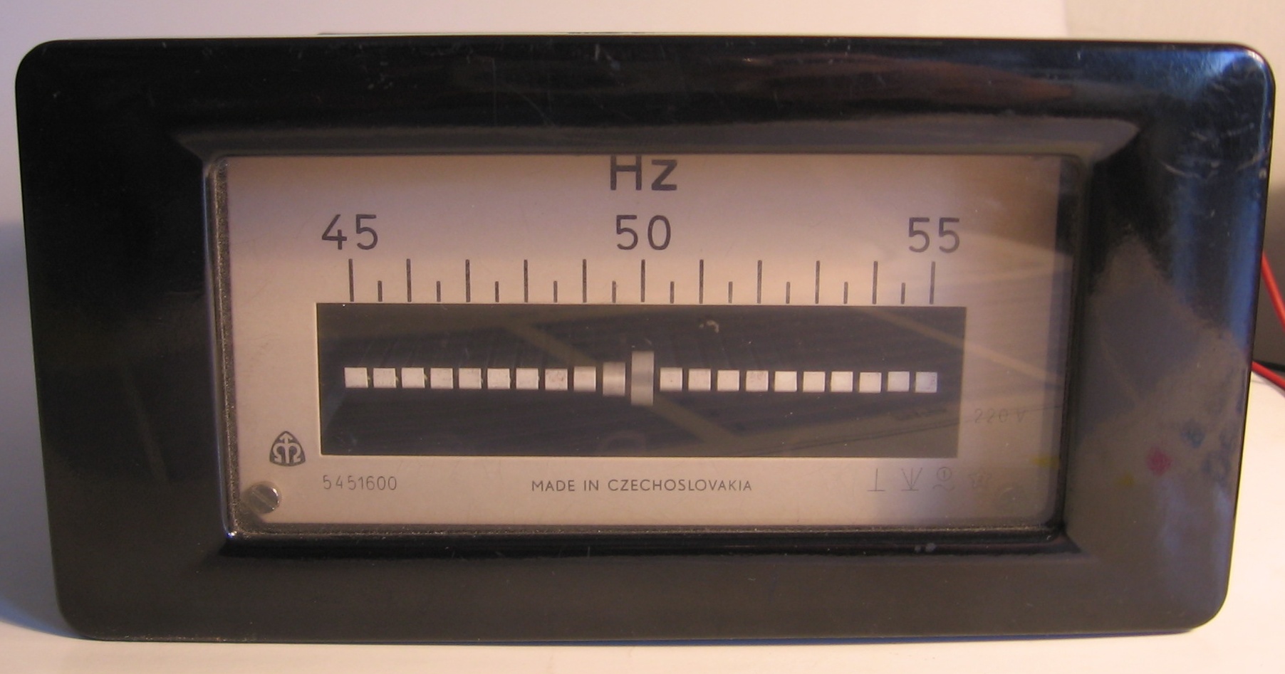

And here a traditional solution:
