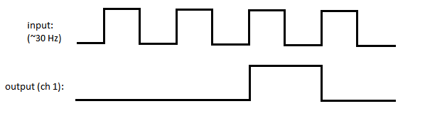

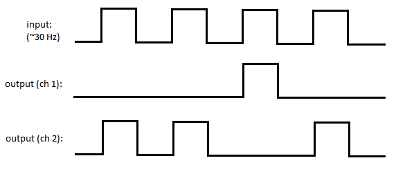

Hi Geoge,
I'd like to clarify what you're trying to do.  From your earlier statement:
I'd like to copy 3 of 4 pulses but the fourth pulse, I'd like to send out a second output port.
Does the following graph represent what you need?
If so, the best way would be to use a board that supports Clocked digital I/O (I would look into the PCIe 6230 if you have a PCI Express slot available in your PC, if not the PCI 6220 is a good alternative).  There isn't going to be a way to get exactly the above signals using your 6711 (which does not support change detection nor does it support clocked digital I/O--the above solution requires the use of both).
Having said this, you can perform the following on your 6711 using a Counter Output task set to Pulse Mode:
Let us know which one of the above you'd like to go with (or if it's something else entirely) and we can provide more details about how to set up the task.

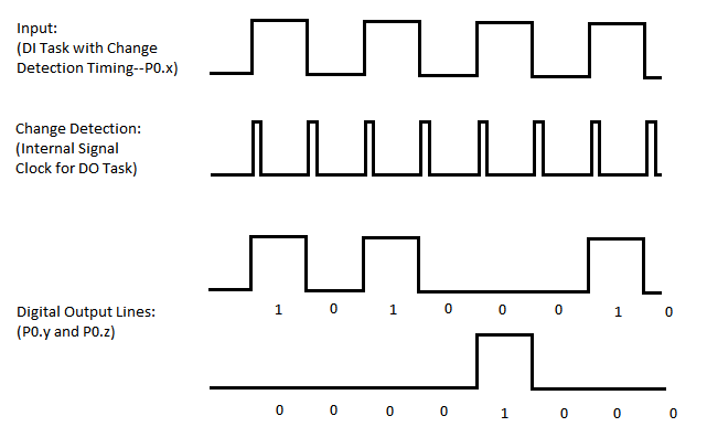

Hi George,
Sorry, I meant to say 6320--thanks for bringing it up.  The 6321 is essentially the same board but with the analog outputs (you could do the same thing on any 63xx board, I initially chose the 6320 since it is the lowest cost--the other X Series boards have different channel counts and different AI and AO specs).
In any regard, the configuration is going to look like this:
You would configure a Digital Input Task for a single line using Change Detection timing (set the change detection to occur on both rising and falling edges of this single input line).  This generates an internal signal called "ChangeDetectionEvent" every time the line switches from high to low or from low to high.  You would then use this internal signal as a sample clock for a Digital Output task which would consist of the two output channels (with the necessary data to be generated).
Port 0 is the only port that supports change detection and clocked digital I/O on our X Series and M Series boards (but you can configure each line as an input or an output individually).  So, after using one of the lines for your change detection input signal, you could have up to 7 outputs (on boards like the 6320 or 6321) or up to 31 outputs (on boards like the 6323).
To get started, I would look at the following shipping examples:
ReadDigChan_ChangeDetection
ContWriteDigPort_ExtClk
Best Regards,
John Passiak
Message 9 of 40
(8,736 Views)
