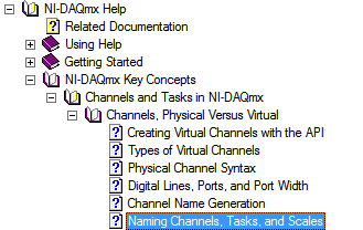

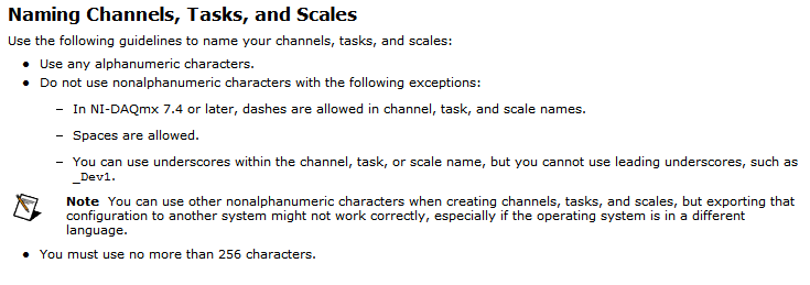

Hi Marc,
The information you need can be found in the DAQmx Help:
To find it, you can navigate to the page as follows:
I wish I could provide a direct link, but alas the DAQmx Help is not yet available online.  However, it should be installed on your computer with DAQmx when using the default install options.
