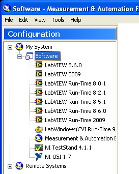

Did you install "Device Drivers?"  Send a snapshot of MAX Software" like the attached;

Thanks, Jeff.  Here's the screenshot.

Hey Leland,
It appears that what you are running into might be a bug.  A corrective action request has been filed (CAR #:196232).  It appears that a dependency was added for DAQmx IO controls in CVI such that runtime engine 9.0 or newer is required.
The workaround here should be rather simple: Upgrade to CVI Runtime Engine 9.0 or newer: http://joule.ni.com/nidu/cds/view/p/id/1285/lang/en
Sorry for any inconvenience, and thank you for bringing this to our attention.
