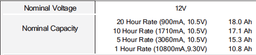

That is only approximately correct. The ampere-hour product is valid for discharge at the nominal rate. For typical lead-acid batteries the nominal rate is for a 20 hour discharge. So 18 Ah/20 h = 0.9 A is the nominal discharge rate, often designated C. For discharge rates greater than C, the capacity is usually less. The image below is from the data sheet for a 12 V 18 Ah battery.  At 2 A you would probably get 7-8 hours.
By the "at least" I was assuming that the actual draw is significanlty less than the rated max 2A, not about the complicated dependence of capacity vs dischange rate. 😄
