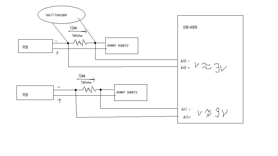

here is the rough schematic..
for wiring diagram, I followed the NI DAQ assistant
I was thinking about common ground as well..
should I do something on USB-609 ?
I guess I'm not perfectly understanding about ground point in testing setup overall.
(well, I understood what you tried to explain, thanks )
(3,765 Views)
That helps a lot.
A few more questions: Are the two power supplies connected to each other in any way? Do the power supplies have any connections to ground?  Which terminal of the oscilloscope is grounded?  Do you have anything connected to the USB-6009 grounds?  Are there any other connections to the PCBs? The USB-6009 has an internal connection to ground on each of its analog inputs.  This means that currents to ground may be flowing in places you do not expect.
