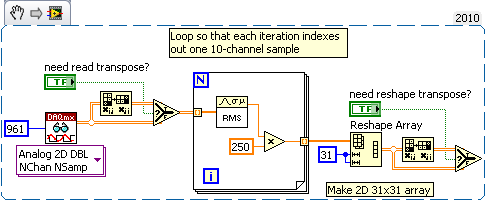

6.  After doing #5, you could get rid of both For loops and replace them with something like this:
Note that the 2 transpose options are only there b/c I don't have a good way to verify
whether they're needed or not.  Get rid of them if they aren't necessary.
