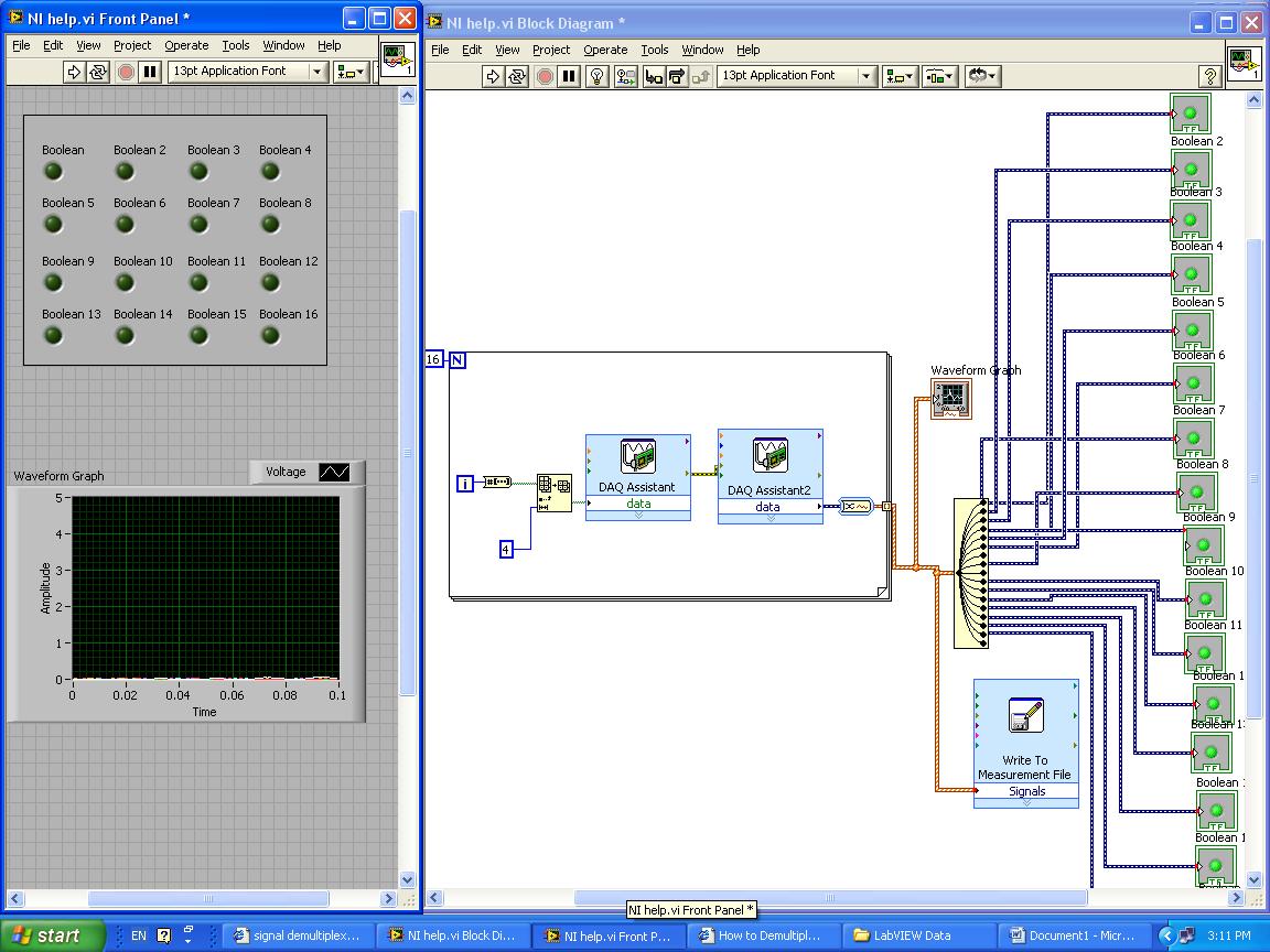

In my application, I need to scan the sensors value continuously, chase the sensor value variation and save the analogue signals in files for processing. I have connected just 16 sensors with one MUL (16-Channel) and I did the following program:program.JPG
Please, could you tell me how I can speed up this process.

Hi Ibrahim,
The best way I can think of to speed up your VI would be to replace your DAQ assistant's with low level DAQ functions. There are lots of examples of how to do this in the LabVIEW help:
For your first DAQ assistant this guide may help:
Step 1: Go into LabVIEW and go to help.
Step 2: Click "Find Examples"
Step 3: On the browse tab, on the tree table click "Hardware Input and Output" > "DAQmx" > "Digital Generation" > "Write Dig Chan.vi"
and the second, have a root around in the Analogue folders in DAQmx on the same tab as above and there should be some more examples in there.
Using low level DAQ functions will speed up your process because the DAQ assistant is an express VI and has alot of other things it does which slows the read and write time down.

Hi Owen,
Thank you very much for your help, i have just solved the problem. I have decreased the samples number and increased the sampling rate frequency and every thing is going well.
