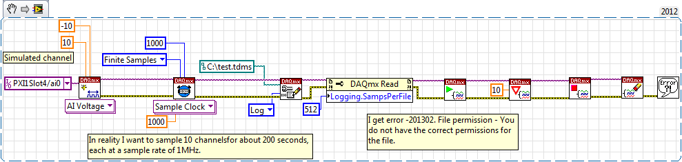

tdms file spiltting - error -201302 file permission
I am trying to set up tdms logging such that it automatically splits the tdms files into predefined file sizes using the DAQmx Read property Logging.SampsPerFile, however I get error -301302 file permission error.
Can anyone shed light on the cause?
I have also tried additionally setting Logging.FileWriteSize with the same results.

It would appear to be that you can't use with a simulated DAQ device - tried same code on a system which does have the DAQ card fitted and all is good.
