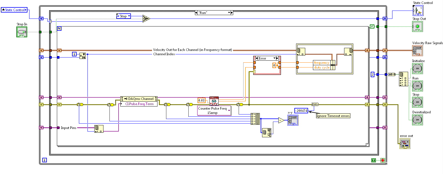

I am attempting to internally mux my Daqmx to read a sample of frequency from 8 input pins.
My current method works but it is slow. 500ms to read 8 channels.
However when I have the rest of my Tasks running on my daqmx 6343 the time it takes to read 8 channels jumps up to 2000ms.
Theoritically since i have a 30 ms time out on my read  it should take
(30ms time out + 5ms read/write/time/jitter) * 8 = 280 ms aproximatly
Why am i getting such bad performance on this task?

You must be on a USB-6343 (as oppsed to PCIe).  The constant reconfiguration of the device across USB is causing the loop to run slowly (I'm not sure what the rest of your tasks are doing, but if it involves continuously transmitting data across the bus then this would add to the latency as multiple resources are competing for the same bandwidth).  I suspect that you would be slightly better off by configuring multiple tasks and switching between them compared to reconfiguring a single task multiple times.  The best improvement however would be to switch to a bus with lower latency like PCIe.

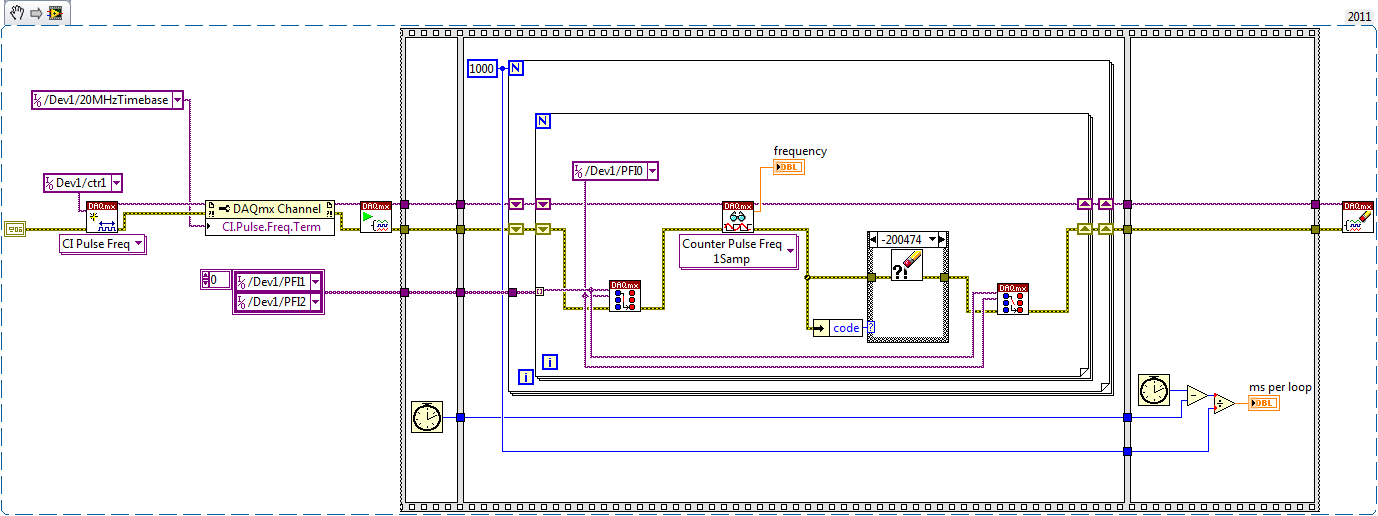

I don't have a USB X Series available to validate my theory about multiple tasks vs. reconfiguring a single task, but I ran this benchmark on my PCIe-6351 (ctr0 is generating a 20 MHz pulse train in all cases--I kept my source frequency high to try to isolate the overhead of reconfiguring/switching tasks):

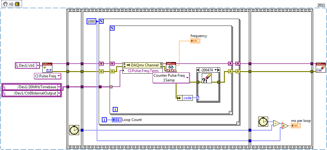

Reconfiguring a single task (similar to what you are doing now):
2.1 ms per loop (or ~1 ms per channel).

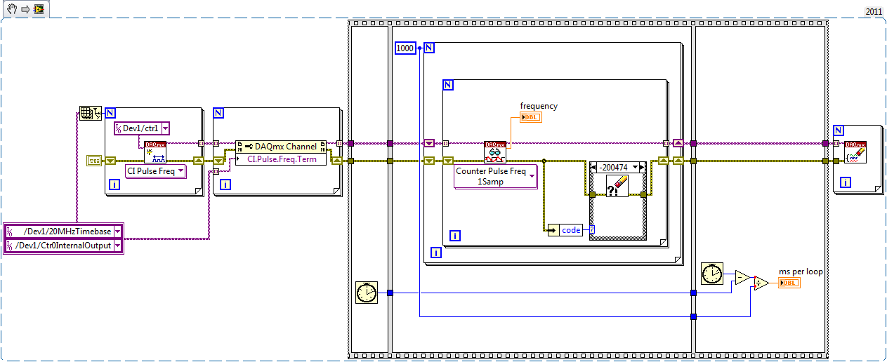

Switching between tasks:
0.69 ms per loop (~0.35 ms per channel, roughly 3x faster than the first benchmark).

I'm not sure exactly how this will translate to a USB X Series, but as the overhead is likely order(s?) of magnitude higher than on my PCIe card I'd expect it to be worth your while to try configuring multiple tasks rather than reconfiguring a single task.  You could also look at your other tasks and see if they could be optimized a bit--it seems they are introducing quite a bit of overhead.  If you need to be able to reconfigure the device more quickly I would consider a PCIe replacement for your DAQ card.

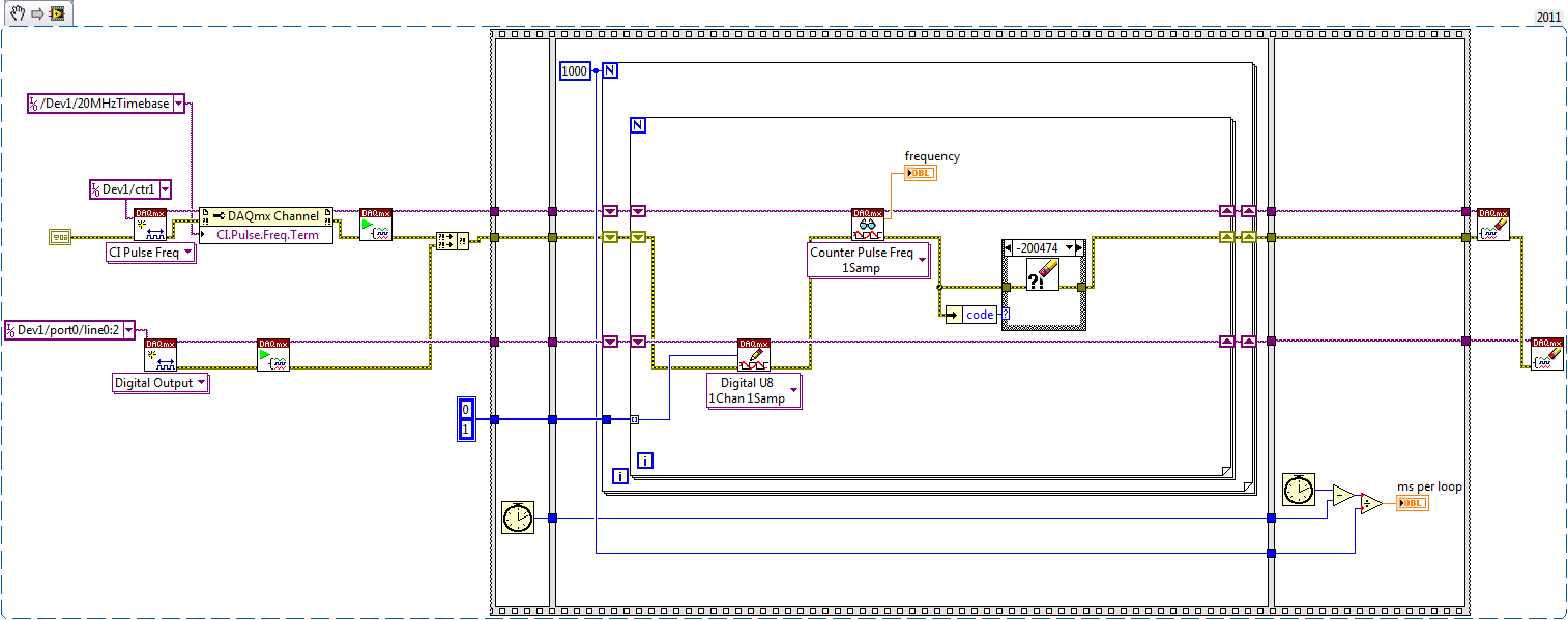

That got me thinking though...  If you used a digital write with an external MUX you can probably get better results:
Digital write to control external MUX:
0.04 ms per loop (about 16x faster than what I've benchmarked so far).  In reality you'd also have to have some additional delay after toggling the DO line to guarantee that the MUX has switched before taking your counter reading.
You might want to try a benchmark like this on your actual hardware before you set everything up to find out that it doesn't give the result you need.  These PCIe numbers give you a relative approximation at best, but might not be indicative of what you'll see on a USB device.
