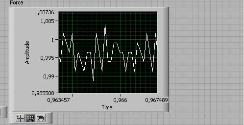

Maye it can be helpful if I put other pictures of the problem.
Here are the signals and their FFTs:
Here are some close up of the signals and a test panel on the channel 0:
As you can see the results from accelerometer can be accepted but that's not the same for the force channel where the noise is not neglectable compared to the voltage of the phenomen I'm studying.
If I try to connect an oscilloscope to the signal that gets out from conditioner I can observe a noise  that seems completely different (much higher frequency and much lower amplitude) from the one I observe on the Labview.
Is there a way to solve this?
Thank you a lot for your answers,
Marco
(4,113 Views)
Marco,
Some of what you are seeing is the limitation of the USB-6009.  On the 10 V range, single ended, the resolution is 2.4 mV.  That is what your images show.  The specifications also say that the system noise is 5 mV rms.  Your data is well below that.
Your acceleration signal is large enough that you cannot change ranges.  You might try a more sensitve range for the force signal (if the USB-6009 allows different channels to ahve different ranges). Otherwise you will need an external amplifier for the force channel.
The force signal looks pretty clean to me, especially if it is a hammer impluse.  What are you trying to measure that the noise is too large?
