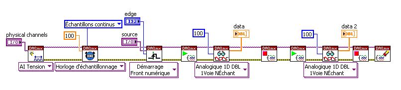

Dear  Chad A and John P,
Thanks for your answers. I have tried to simplify my code to the DAQmx part and here is what I would like to do :
Of course, this simplified vi is working fine ! I stop/start the task so the trigger works fine for both samples.
Now it is not working in my original code so I have to track down the problem in the code. Clearly, I am not doing what I think.
Could you just confirm that the code above is ok ?

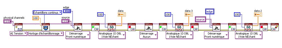

Well the previous simplified code was not exactly what's in my code. Here is a new one and this one is not working.
Have you got any ideas ?
It is the fact that I want to remove and re-add the trigger that is not working. I don't see what the problem may be.

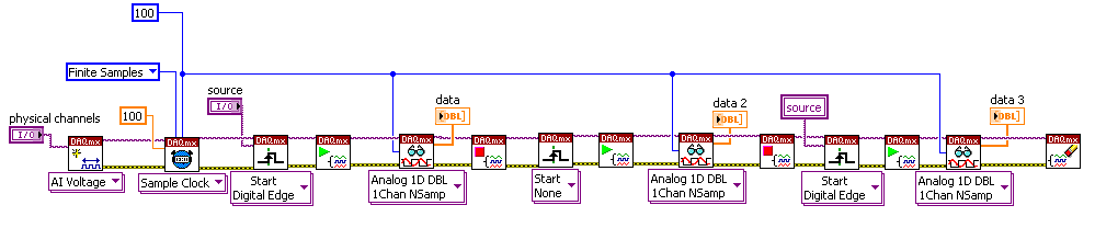

Hi Felicien,
I tried running the following (I think this is the same as your code, but I am not 100% positive--my French is not very good):
Anyway, I didn't notice any unexpected behavior.  The code performs the following:
1.  Configure the task to use a Digital Edge Start Trigger.
2.  Acquire 100 samples after the first digital edge is received.
3.  Restart the task, but with no trigger (this takes several milliseconds).
4.  Immediately acquire the next 100 samples once the task has restarted.
5.  Restart the task, again with a Digital Edge Start Trigger (the restarting again takes several milliseconds)
6.  Acquire 100 samples after the Digital Edge is received.
7.  Stop and clear the task.
Is this the behavior you are expecting?  If you are seeing any behavior contrary to this, could you let us know what exactly is happening in your application?

John
This is exactly the behavior I am expecting.
However, in my application, the first digital edge is correctly seen and the first 100 samples are recorded.
Then the next 100 samples are recorded.
But the second digital edge is never detected although I use the same external device to send it on PFI0. The third "analog read" exits after timeout.
I use Labview 8.5, I have tried it on two PC, this is reproducable.
Does it make sense .
Félicien

Hi Felicien,
I changed my code to Continuous and still get the same expected behavior.  I am running DAQmx 9.0.2, what version are you on?
Are you positive that there is a trigger signal on the line after the task is restarted?  Remember, the device will not detect any triggers while it is being reconfigured.
Best Regards,
John Passiak
