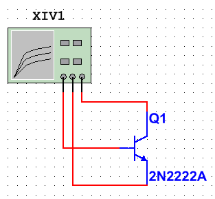

I used the IV Analyzer instrument to plot the collector characteristic curves of the transistor and here is what I got:

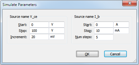

As you can see in the simulation parameters, the instruments sweeps from 0 V to 100 V (VCE) and 0 mA to 10 mA (IB). IB=0 is very small, that's why you can't see it here.
Hope this helps.

How to open Simulate Parameters Dialog box? I can't find it.
Message 7 of 10
(9,349 Views)
Accepted by topic author jayanthd
Place the IV Analyzer instrument and open its front panel. Then click on the Simulate param button to open the Simulate Parameters window.
Fernando D.
Message 8 of 10
(9,337 Views)
I got it. Thank you. I didn't get the graph you showed after simultion but after changing the values with the values you have used after simulation I got the graph that you have shown. See attached video. I need to set the values after simulation to get the proper graph.
