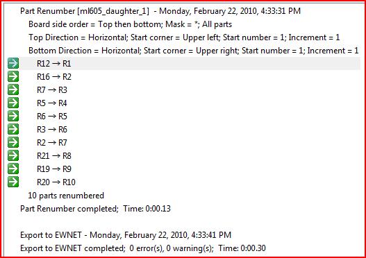

After finishing a layout in Ultiboard, I would like to renumber each Refdes of my parts to make physical sense (left to right, top to bottom).  I go to Tools->Renumber Parts and use the mask "R*" to only renumber my resistors.  I see the following output.

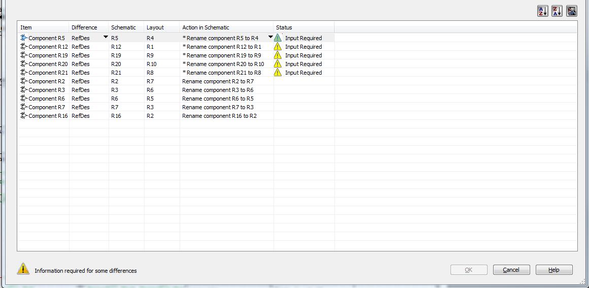

Now, when I try to backward annotate these changes to my schematic, I am presented the following dialog box in Multisim.
The entire table looks correct according to the output of the Renumber operation.  However, Multisim will not complete this operation.  The OK button is greyed out and the window says "Information required for some differences."  Clicking through some options, I see I can tell Multisim "Component R4 in layout is not component R5 in schematic."  This is not the case since Ultiboard renumbered R5 to R4.  I also have the option to "Ignore" the difference.  I don't want that either.

What's happening here is that Ultiboard is renaming refdes' using a standard auto-naming convention. For example, since "R1" is not used in layout, that's the first refdes it uses, and so forth. The problem here is that R1 does exist in Multisim, but as a schematic capture only component (i.e. a virtual resistor).
So in this case, Ultiboard has renamed R5 to R1.  However in Multisim, R1 already exists, but it is a virtual resistor and thus has no matching layout part in Ultiboard. So in Multisim when you attempt to back-annotate, the dialog is properly preventing the renaming from R5 to R1, because R1 already exists in Multisim.
For now the workaround is to rename all of the virtual resistors to something that will not collide with Ultiboard's auto-renaming strategy. In your design, the five virtual resistors are R1, R4, R8, R9, R10 and can be renamed to R1_virtual, R4_virtual etc...  Then, your annotation will be able to proceed as you'd expect.
