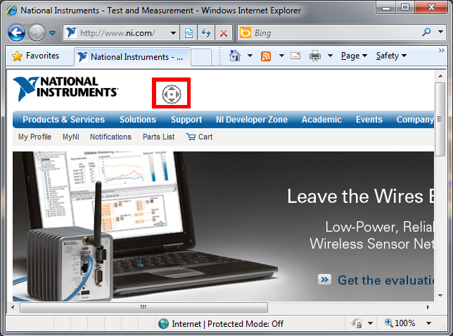

Hi pkbsr.,
I'm using Windows 7 on my computer, and that is definitely not what I'm seeing. However, if clicking the scroll wheel is showing the Alt-Tab flip, then Multisim will not be able to scroll. (It is a quite complicated, but if you are seeing the Alt-Tab flip, Multisim will never know that the scroll wheel was clicked.)
I did  a quick search online to try to come up with why Windows might be intercepting the click. Do you have any Windows customization software installed, for example AutoHotKey? If not, are you able to scroll using the scroll wheel in other applications? For example, in Internet Explorer
  1. Browse to ni.com
  2. Resize the window so you see scroll bars
  3. Click the scroll wheel and you should see the icon highlighted by the red box in the image below. If you move your mouse around, the page should scroll.
