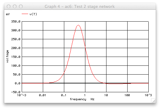

I simulated the coupling and feedback networks (assuming ideal unity gain amplifiers). This is the output with a 1 volt input.

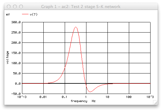

The Sallen-Key lowpass filter has C3 connected at the R5-U2 junction, not as your image shows.
The attached file has the SPICE listing I used. Because I did only AC analysis, none of the DC sources are required. In the listing R2 is the parallel equivalent of your R2 || R3 = 50 kΩ. The op amps are modeled as linear voltage controlled voltage sources with gain of 1 (E1 and E2). R5 was omitted because no current would flow through it. In the corrected Sallen-Key circuit it will be necessary.  Resistors Rv1 and Re1 are probably not necessary but assure a DC path to ground from all nodes.  I do not have Multisim. These files are modeled with a SPICE 3f5 engine.
The file test 2 stage.txt is the listing for the circuit in your image and test 2 stage SK.txt is modified to represent the Sallen-Key circuit.
The plot below is my analysis of the Sallen-Key version.
