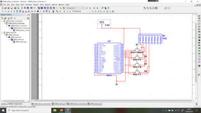

Hi all, can anyone help?
I'm trying to run a simple PWM circuit (4 button, 40%/60%/100%/stop) and I'm getting a strange error. The code was ripped off from https://www.electronicshub.org/pwm-based-dc-motor-speed-control-using-microcontroller/ and I've adapted it for 8051 Hitech C compiler. The code follows along with the 12 linking errors.
Thanks in advance.
