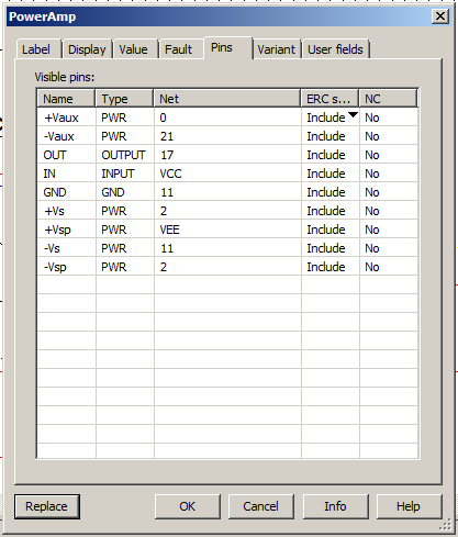

However, in the component properties windows, the "Pin" tab shows a different configuration:
I must have imported this PA107 incorrectly becaue the pre-amp circuit is working as intended, can anyone please provide any solutions?
