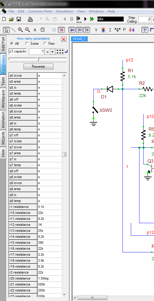

In Multisim, only "interactive" parts (parts that change state such as potentiometer, switches, LEDs etc...) can update the SPICE netlist while the simulation is running, other parts you have to stop the simulation change the model parameter and then rerun the simulator.  I am not aware of the other SPICE simulator that can update the netlist while the simulator is running, can you indicate which simulator, I like to see how this works.

Yes. The software is B2 SPICE by BeigeBag software:
http://www.beigebag.com/
Attached is a grab of the "properties" tab for modifying parameters during the simulation. It is very easy and useful. Since teeh components are "static" it doesn't add to the overall simulation overhead. I'm not sure how the author actually programmed this feature, but it is useful as you can add standard fixed components and simply change the value of any component in the circuit during the simulation.
