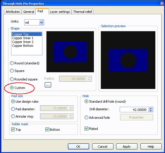

I'm trying to make a rectangular pth pad. Dimensions: 100mils x 60mils with a centered 42mils hole. I have searched the forum, help in Ultiboard to no avail...

7. NOW - Create your desired part with 42 mil holes.   (Use the Part Wizard, Tools -> Part Wizard  *OR* you can create a PCB Part similar to the method of creating part above).   You are only given the choice of using standard TH pads or SMT pads - this is fine as in the next step you will 'swap out' the standard pad for the new pad.
as an example...
8. Swap out pads.... When your part is complete with the round TH pads, highlight the TH pad(s) as needed and right-click to get the properties.  (You must be sure the select pads selection filter is enabled (5th one in)).   Go to the 'Pad' tab and select 'Custom' and choose the rectangular pad you previously created...
9.  Complete this for any of the holes you needed and save (or resave) the updated part (shape) to the database.
10.  Place your PCB component as needed....

Hi Pat,
Thank you for a fast answer. It works perfectly !!! Smiley Happy
