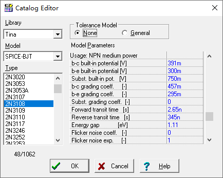

Hi, I want to simulate a circuit of my textbook, using two transistors: 2N3108 (npn) and 2N3638A (pnp).
Both of them can't be find in multisim, but can be find in tina-ti:
Is there anyway to import the transistors to multisim? Or create a new component according to the model parameters listed above picture in multisim?

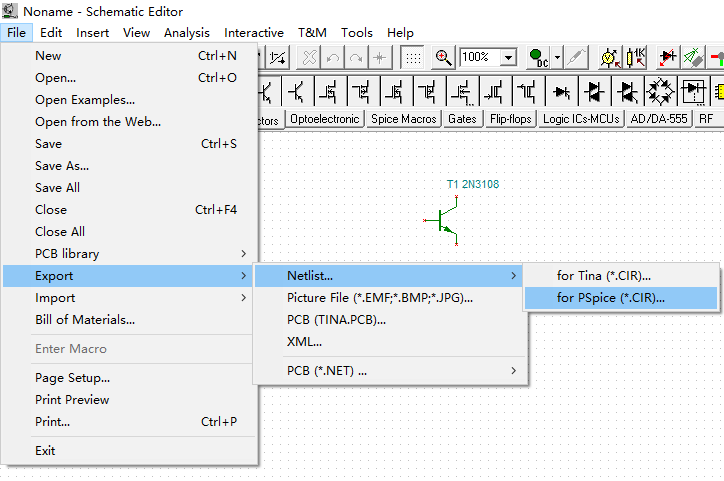

Is there a way to get .cir output from Tina?
(4,993 Views)
Hi, @aestay
Thank you for replying.
Yes, there is a way to export .cir file from tina:

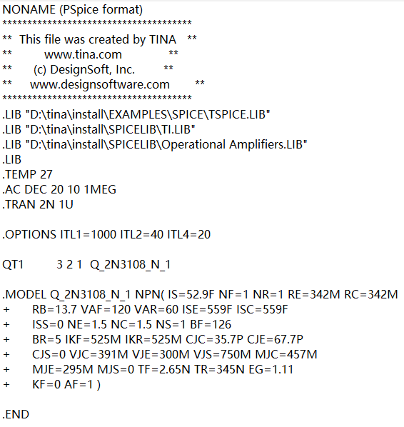

Then a .cir file generated, it contains the following information:
Can you tell me what can I do with the .cir file?

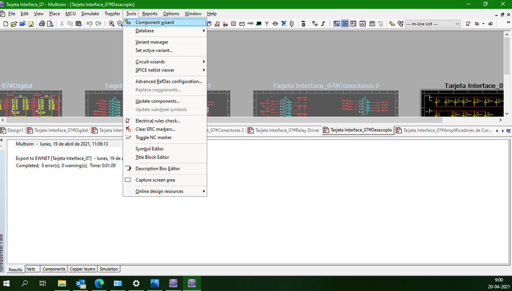

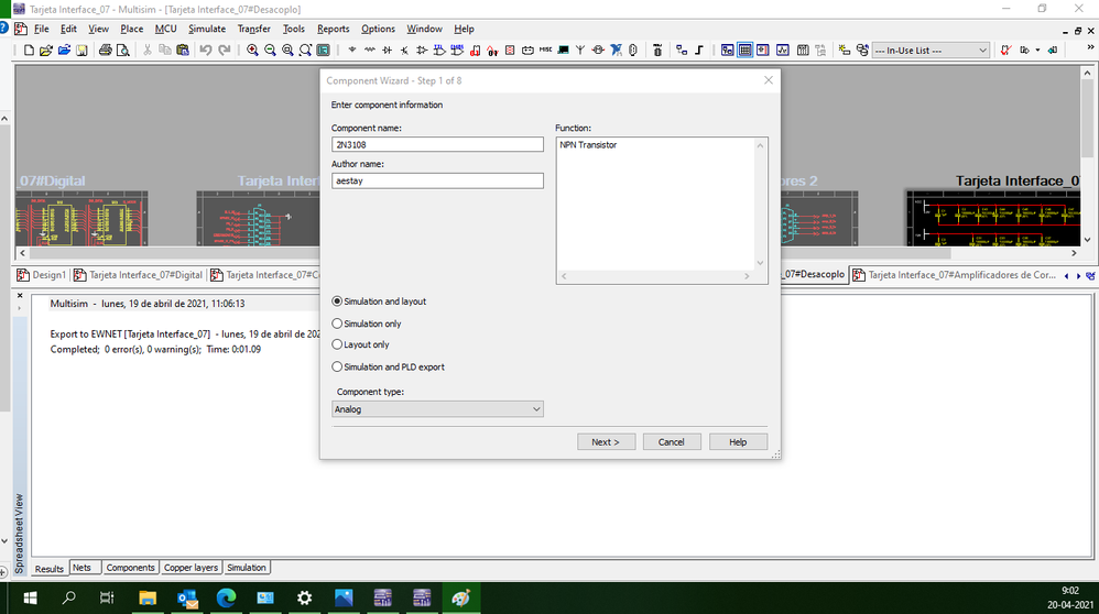

Use the Multisim Component Wizard

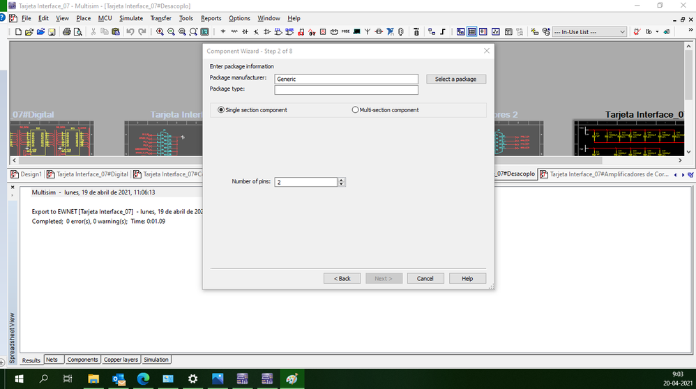

Give your component a name and purpose

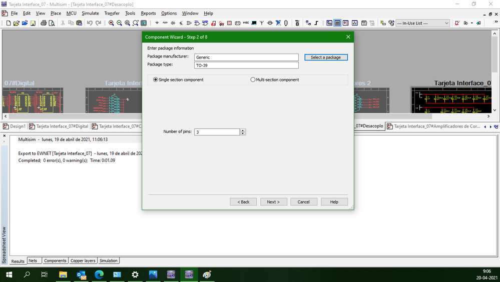

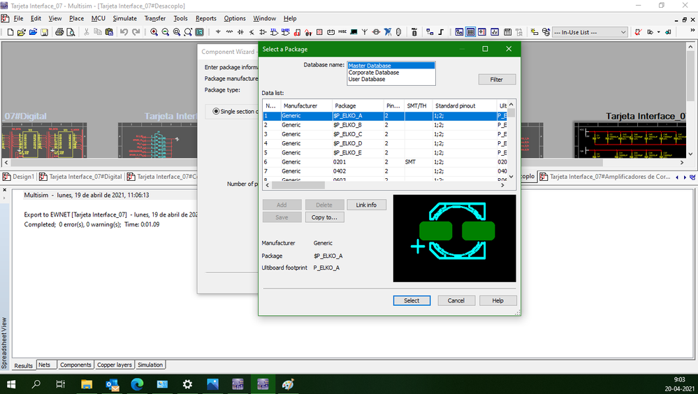

Select pin and packages

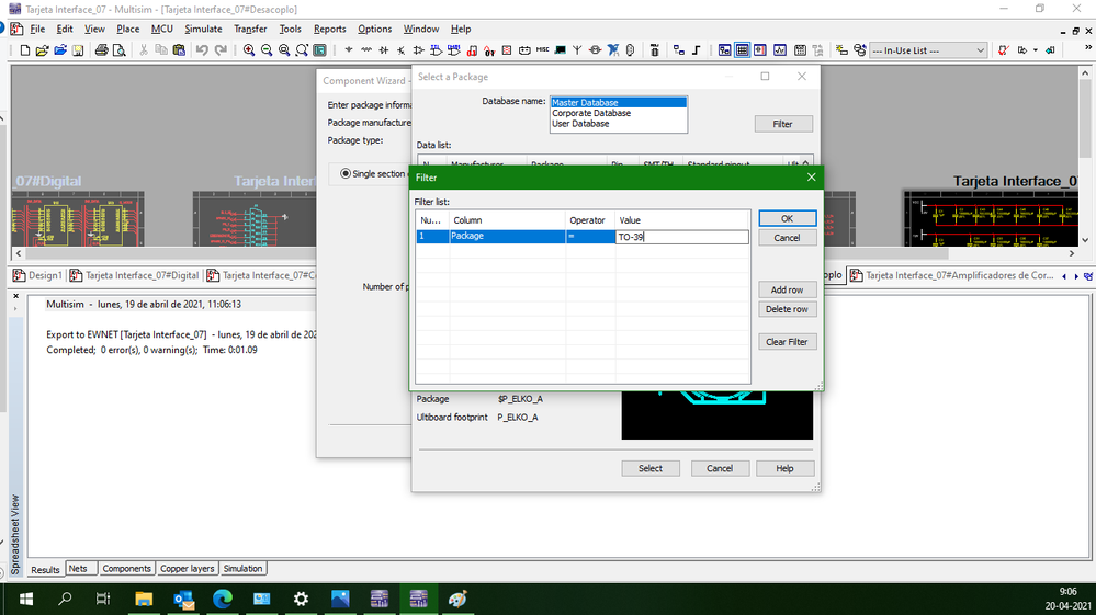

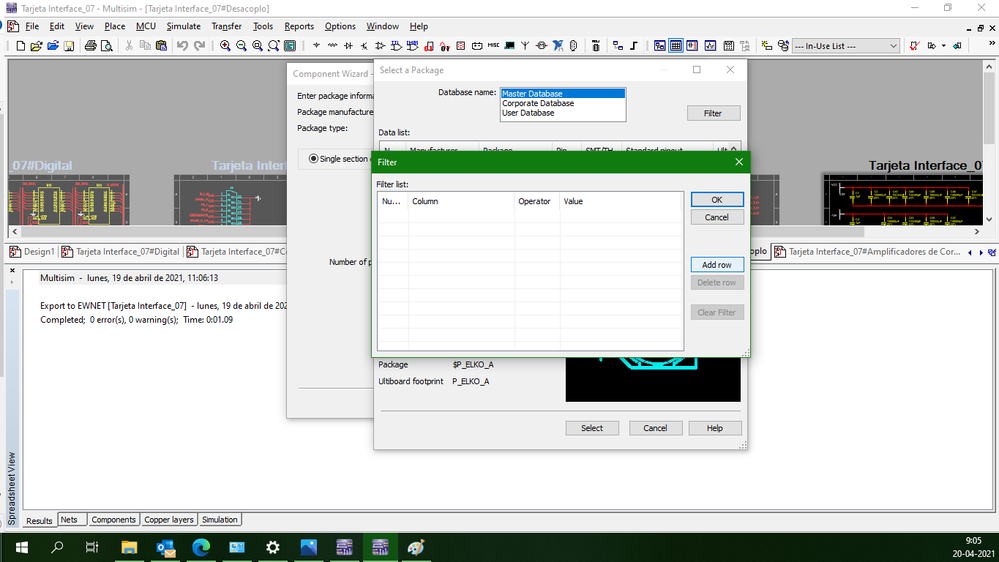

Browse packages matching your component
You can also search with expressions

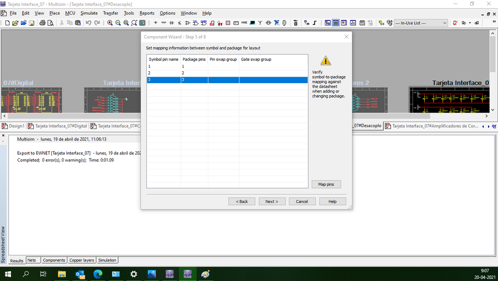

Map symbol pins into package

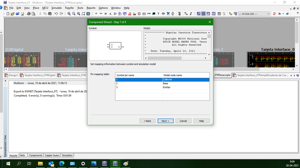

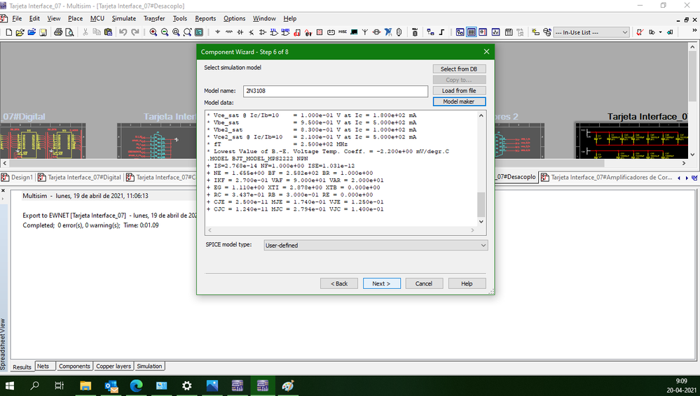

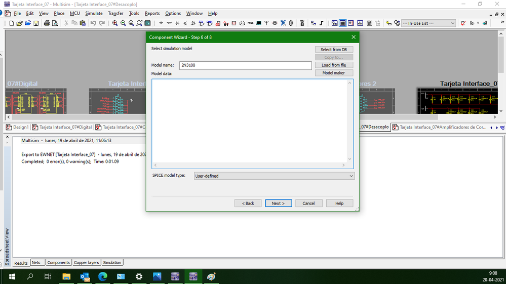

Then put the content of the cir file inside that box
You can also use the model asistants, to create a model from individual parameters without conding directly in SPICE
Map model variables into symbol

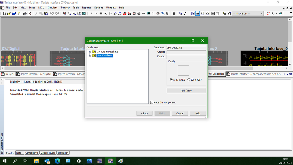

Give your component a Family
Then you can find it in the User Database. Hope this can help you. The model used by Multisim is the Gunmel-Poon model. You can find lots of info about coding in spice or manage spice models in Muhammad Rashid's "Spice for Circuits and Electronics Using Pspice"
