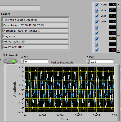

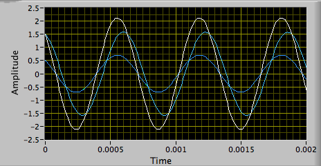

I put together a simulation of the Wien Bridge Oscillator in Figure 8 of the SLOA060 document.  I used a T074 op amp because I had a Spice model of that device.   I also changed to a +/-15 V power supply and grounded the point marked 0.833 V in Figure 8.
When I ran a transient simulation all signal voltages were constant within microvolts of ground.  This is not unusual in oscilator circuits because the only noise in the "circuit" is due to numerical round off in the simulation and it is often too small to start the oscillation. I added the .IC condition at node 3 (non-inverting input to op amp). This is equivalent to starting the circuit with some charge on C1. With the initial condition the circuit oscillates cleanly.
These images are from a LabVIEW program which plots the results generated by the Spice simulator. The LV program has much more flexibility in plotting than the Spice program.  The Spice listing is attached.

Looks good, Great to see you got it working! So what your kind of saying is that if I want to run these sort of simulations in my simulator. I need to figure out how to do a  transient simulation or analysis.

Derek,
Transient analysis tells you what happens over time.  That is what an oscillator does: It converts the energy from the DC power supply into a periodic time varying signal.
An AC analysis tells you how the small signal behavior of the circuit varies with frequency. To do an AC analysis the circuit must have an independent  source with an AC value specified.  Normally you would not have an AC source in an oscillator circuit.
Multisim (I think) is Spice-based, but I have no idea of how they do various kinds of analyses or what restrictions may apply.
Lynn
