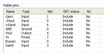

Hey guys,
I need LM386 in my Multisim project but it's not included. I followed the solution given from 'http://forums.ni.com/t5/Circuit-Design-Suite-Multisim/LM386-not-included-in-Multisim-11-0-1/m-p/1432...' by adding LM386 by myself into the library.
But that doesn't work, I cannot get any signal from the output.
and here's my settings on LM386 and it's SPICE file

my osclliscope can only get the source signal...is it my settings go wrong?

I responded to this in an earlier post.   My guess is that its likely a symbol - pin mapping issue.   If you can post the .ms11 or .ms12 file we can certainly take a look at the mapping, but below is how you can check the symbol-model mapping for yourself...
To check (assuming its saved in the database already), you'll need to double-click the part and go to the 'Value' tab.   Click on 'Edit Component in DB' and you will be brought to the edit window and you would then check the 'Model' tab.   From there the Symbol and model nodes are listed...
For the circuit created by Fernando in the previous post, the symbol-model mapping for the LM386 model is this (Important: if your symbol pins in the list are in a different order, you'll need to adjust the model node positions to match below😞
Please check against your mapping and verify.
Optionally you can just download Fernando's circuit in the previous post - > (http://forums.ni.com/ni/attachments/ni/370/9159/2/LM386.ms11)

Hi _user32,
thanks for the reply.  I checked the setting in DB and found out they have been correctly set.
looks like the chip still cannot work...is it because my circuit or something?
