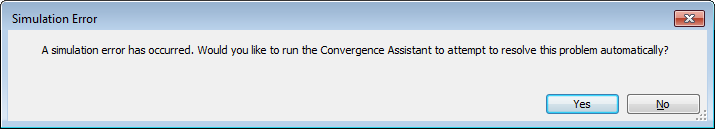

Whats the problem in simulation in multisim
I want to know that when i try to simulate it gives me error can anyone please tell me whats the problem is?

Dear Sir,
I have applied the following settings which you told me in the link.. But I am still facing the same problem.
It gives me the error of Covorgence Assistant and when i run it , then it say
"Multisim Convergence Assistant Log
Step 1: Verifying Error Scenario
...could not reproduce the error
" and after words when i try to simulate it give me same problem.
I don't know whats the problem in it...

Try setting your initial conditions to zero in addition to the above changes:
It seems this circuit is particularly sensitive to convergence issues.
Also if you are using 14.0, the new measurement probes can be a very useful alternative to instruments and can help when running into convergence issues.
Let me know if that helps,
Jeff
(10,436 Views)
Thanks I find these above tool useful and the circuit is i dont know why is sensitive to convergence issue but above setting helped me out.
