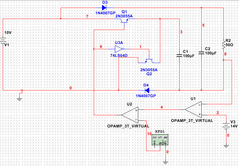

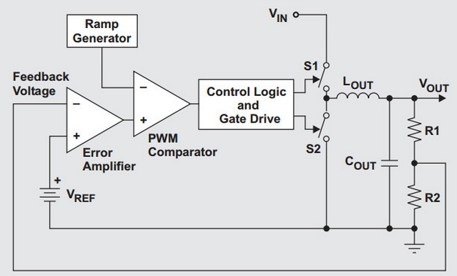

I simulated successfully this Switched Capacitor DC-DC converter which step up input voltage..Now main task is to  maintain output at fixed 14V irrespective of input.I am trying to implement this through PWM which will provide variable duty cycle to switches.Ouput of converter be compared to fixed reference of 14V then comparator will estimate error signal..that error signal will be compare to sawtooth which generates switching signal for switches,I tried this but it is not working.plz guide where is error..2nd I am directly giving output of converter to comparator is this correct way..as shown in below fiqure output of converter which is Vo actual while Vo desired is fixed 14V for my case ..it will estimate Ve which will be compared to sawtooth to generate particular pulse width..This sawtooth magnitude and frequency would be how much for this case..any formula or lgic for this setting,,

This is actual simulation file in Multisim.Input supply will be from 8 to 14V while output should be fixed at 14V through PWM control technique.This circuit is step up converter which  is inductor less.On output 14V is required as this circuit will charge 12V battery at fixed voltage.

A typical buck converter is shown as follows.

If u kindly introduce necessary changes in my multisim file which was with previous email.Novality of this circuit is that it is inductor less boost up converter as I am doing it for research work so cannot use inductor as you proposed.Second my main concern is how to maintain constant 14V at output.Load in my case is battery which will be charged through this circuit and battery internal resistance is normally 5 mohm or less so then how I can form resistor divider circuit at output.
Please guide how to stablize this circuit at 14V using PWM technique or modify multisim file.

Yes capacitor here works as energy storing element.In my first post I attached multisim file in which DC-DC control technique through PWM is done.Load for this circuit is 12V battery which will be charged through this charger.PWM main purpose is to vary duty cycle of both switches T1 and T2 in order to maintain 14V constant at output while input varies from 8 to 14V.But my circuit is not given correct output that'swhy I asked where is error in multisim file.

I do not have Multisim. Can you post an image of the schematic diagram?

Here is the original one without the inductor:
