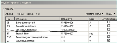

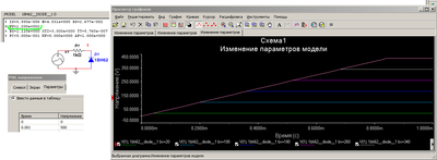

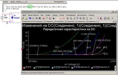

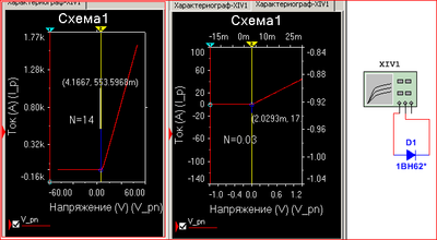

Hello, dear friend! (can I call it that?, -usually, the Chinese treat it like that, I like it)
The emission factor is usually recommended from 1 to 2, but in the 1BN62 diode model it is 4 (!!!)
Since Multisim is breaking the rules, why don't we step back and get creative with it? We now know that two parameters affect the threshold voltage.
And this is how the reverse voltage parameter affects
